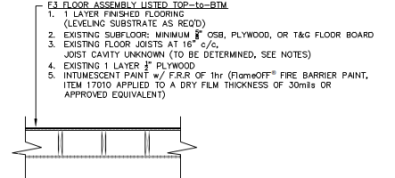

Or the design for a one-hour separation that required STC 50. Let me know where the problems are:
I mean, I wouldn't want you to lose touch with the common folks on the front lines.....
#1 Rejected. Non-compliant with Div. C 2.2.2.1.
#2 Rejected. Non-compliant with Div. C 2.2.3.1.(1)(d)
If these are from design professionals, you should lodge a complaint with their professional associations.
The second one was from an engineer. (!)
That was my assumption. It makes sense that they don't have anything for STC as that is normally the realm of architects (acoustics engineers being the exception).
Are they also in violation of the joint practice agreement?
Reno of existing building; the application came with verbiage to indicate they'd actually read the agreement.
