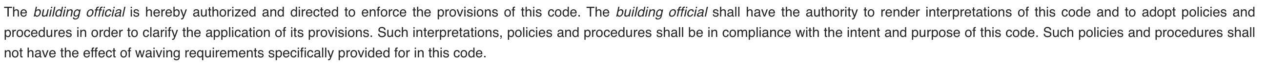

I continue to see and hear of situations where inspectors and building officials have personal opinions that conflict with the codes as written and enforce their opinion vs the written code which conflicts with their opinion. Some will point to the statement code section below:
The biggest abuse of these personal opinions is hanging their hats on the "...authority to render interpretations..." and ignore the part where it says "...not have the effect of waiving requirements specifically provide for in this code." That makes a big difference.
We are suppose to be facilitators of the code and to a degree educators. Our work is not suppose to be a social visit and always be the good guy. I believe that many out there just don't like being perceived as the bad guy/girl and as a result of the lax enforcement, make it harder for everyone else by confusing contractors as to what is actually required. How many times did you hear the phrase similar to this? "I just did the same thing in another jurisdiction and it passed."
If you haven't noticed, I bring this up every few years to discuss. In addition to the happy go lucky, complacent enforcement officials we have the opposite which is just as bad. I am talking about the "Do as I say, I don't care what the code says." attitude where officials make contractors do things that are not required. This creates a lot of animosity in the industry from the RDPs to the contractors and homeowners.
Yes, we all make mistakes and none of us are perfect. We are going to miss things but that is not what I a talking about. I am really talking about intentional ignorance to the code by either coming up with excuses why you don't have to enforce the code or making up your own requirements that are not in the code.
Thoughts?

Enforce what is written in the code, do not make things up, and be able to back up the requirement with chapter and verse. Be willing to have a professional discussion if there is other information that the aggrieved party wants to present. Be a student of the codes so you may offer a reason for the code requirement and be able to offer alternatives compliance methods.
Chapter 1 is the most import chapter of the book, it lays the ground rules.
When presented with a dilemma consider:
101.3 Intent. The purpose of this code is to establish the minimum requirements to provide a reasonable level of safety, public health and general welfare through structural strength, means of egress facilities, stability, sanitation, adequate light and ventilation, energy conservation, and safety to life and property from fire and other hazards attributed to the built environment and to provide a reasonable level of safety to fire fighters and emergency responders during emergency operations.
Contrary to what the contractor believes the code is not gray and only subject to interpretation if the words are not there.
Uncovered issues in the current edition of the code or forward thinking alternative such as those found in the next edition of the code are allowed under:
104.11 Alternative materials, design and methods of construction and equipment. The provisions of this code are not intended to prevent the installation of any material or to prohibit any design or method of construction not specifically prescribed by this code, provided that any such alternative has been approved. An alternative material, design or method of construction shall be approved where the building official finds that the proposed design is satisfactory and complies with the intent of the provisions of this code, and that the material, method or work offered is, for the purpose intended, not less than the equivalent of that prescribed in this code in quality, strength, effectiveness, fire resistance, durability and safety. Where the alternative material, design or method of construction is not approved, the building official shall respond in writing, stating the reasons why the alternative was not approved. See 104.11.1, 11.2
