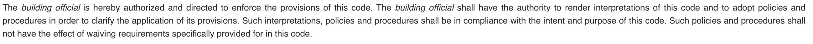

Your Opinion vs What the Code Reads / Intent
I have seen, prior to that sentence getting added to 507.1 a type I hood in a restaurant remodel repurposed as a type II. The new duct was light gage slip and drive appropriate for a type II. I think that sentence was added in 2009 IMC.
Unlike the wall that shows up on the jobsite as unassembled studs and drywall, The problem here is it is already called a type I by the manufacturer and UL before the plans were even drawn. Then 507.1 says if a type I hood is installed the entire system has to meet type I requirements.
As far as voiding the listing, as soon as light gage duct or any other component does not meet the requirements of a Type I hood system it can't be used as a type I hood. Does that void the listing of the hood?
So if I buy a used type 1 hood and put it over my dishwasher, It can't qualify as Type 2? The IMC does not require a hood to be listed and labelled...

The intent is when it is required to be type 1....it is all type 1....If it is an unlisted/ unlabeled hood (as allowed), how do you know.....?
This is like the old guard argument.
Patio/deck, under 30" from grade, someone decides to be safe, or make it pretty, adds a system, that kinda looks like a guard, but doesn't meet the requirements.
Not required, stick to what is required for the application.
I have an office in my house, with no windows. For real. Without furniture, it looks like a sleeping room, has a closet (w/shelves), but no smoke detector. Should requirements for a sleeping room been applied? I think not.
JMHO
I can buy into an old unlisted type I hood because then there is nothing specifically calling it a type I hood. If it is listed and labeled as a type I hood that's a different matter. The code doesn't say where a type I hood is required, it says "where a type I hood is installed, the installation of the entire system, including the hood, ducts, exhaust equipment and makeup air system shall comply with the requirements of Sections 506, 507, 508 and 509."
If a type I isn't required and they don't want to spend the money on a full type I system, take out the listed type I hood and put in a type II. A good tinner can make one pretty quick, its just a big box. I've done it in under an hour, even in the days before we had a plasma table to cut everything out for you. Probably for less cost than they could turn around and sell the type I they have on eBay.
HOOD. An air intake device used to capture by entrapment, impingement, adhesion or similar means, grease, moisture, heat and similar contaminants before they enter a duct system.
Type I. A kitchen hood for collecting and removing grease vapors and smoke. Such hoods are equipped with a fire suppression system.
Type II. A general kitchen hood for collecting and removing steam, vapor, heat, odors and products of combustion.
If what is provided is in excess of what the code requires the building department is not concerned.

There is nothing saying that a hood over an appliance that only requires a type II hood is designated as a type II hood, it says the appliance can be under either a type I or a type II.
I know the commentary is not code, but it is a tool to be used to help in interpreting the code. Here's what the commentary says regarding this: "If such type I hood is connected to duct suitable for only type II hood systems, a fire hazard could result. Building owners and tenants could think they have a type I hood system when viewing the hood, not realizing that the hood system is actually a mismatch of a type I hood with ductwork that is not compatible with a type I hood.... If the type I hood was later used with appliances requiring type I hoods, a severe fire hazard would result, unknown to the building owner or tenants. The code intends to prohibit the installation of a system that is misleading as to its capabilities, application , and purpose."
This goes back to the main question of 101.3, the intent of the code. A completely different example, but I want to heat my garage, which is in excess of what minimum code requires. Is my garage heater subject to code requirements?

I fear that what is perceived as the intent of the code is being used by some to impose there personal preferences.
Asking if a garage heater is subject to the code suggests that one is not familiar with the code. If you install something that something must be compatible with the laws. But that doesn't mean that the heater must be able to maintain a given temperature.
Using the proposed logic would suggest that if I used a floor joist that had a greater capacity than required that I would have to design all of the columns and footings for this higher load. If this is your intent then I suggest that essentially all existing buildings were not consistent with the "intent" and that they should be all condemned.
Look at how lawyers and the courts interpret the meaning of the code. You do not enforce the intent. You enforce the written law. You use the intent to help interpret the code when there is a real, not contrived, ambiguity.
I was playing a bit of devil's advocate with the garage heater scenario, but wasn't even considering ability to maintain a certain temperature. I was talking about the installation itself. There are those that would try to take the interpretation of "not required" that far.
Back to the hood scenario, it IS written law that if a type I hood is installed (not required) the entire system must comply with type I requirements, so are those who allow lesser duct, etc. going with their own personal preferences and not the code as written?
