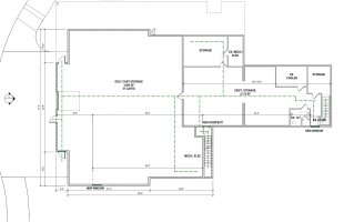

Thread 'Stockroom Egress Pathway Separation'
Has anyone come across an easy and cost effective solution to create pathways compliant with 1014.2 exception 2.4 thorugh a stockroom adjacent to an M occupancy? This is an interesting situation - we had an existing warehouse that was used mostly as an M but also as an S; the tenant operates a rental business for event furniture and equipment (chairs, tables, etc.). They wanted to create a dedicated retail storefront area in the front of their tenant space (bottom left 2,024 SF)...
