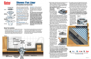

They have progressed beyond the under-slab plumbing and have attempted a pair of shower pans.
I used to be surprised at the balls to the wall inexperience......this is a good example of the "We are educators and are duty bound to explain the details of the defects and solutions." I went as far as to write "Hire a shower pan installer for a built-up pan." I did not tell them why.
