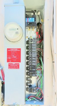

The wires are before the meter and live with or without a meter installed.

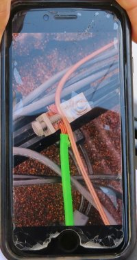

The service was done by the same company that installed solar on the roof. The roofing is tile so I have to rely on pictures of the array.
There can’t be more than one wire in that lay-in lug.Is the ground wire clamp correct? Looks like the green wire is not under the screw very well.

That would not be legal.Did you allow the Siemens breaker in the Eaton BR, "Zinsco II" panel, going into UL listed, vs classified quagmire, not seen anything allowing Siemens QP, or it's lookalike cousin Murray MP, to be installed in any competitive panel.
