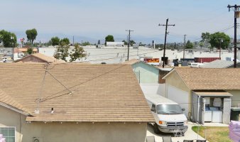

The job is a kitchen remodel. I was there for the final inspection. There are corrections. When I asked to see the service panel the owner asked me if I would tell Edison to hook up the power. I told her that I don't tell Edison to energize .....only de-energize. So I took a look at the service drop and sure enough, Edison didn't hook it up. As it turns out the service was replaced about four years ago and it was never released to Edison. This took place on a Friday so I haven't looked at the address file to know if a permit was issued. I hope so.....and not just issued, but with a final approval as well.
I see couple each month.
Does that mean they have not had power for 4 years?
The pictures show temporary connections of Edison’s service drop to the service entrance conductors. That is a technical code violation.....the service equipment is not supposed to be energized until it is approved. People can’t be without power while waiting for inspection and then waiting for Edison to hook it up. The practice makes it easy to spot bootleg panels.
