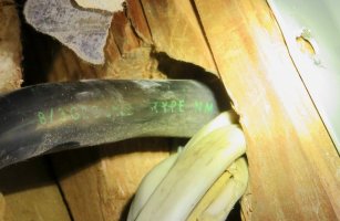

I guess that I'm not old enough to have seen much of this type NM
