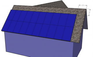

I didn’t inspect that installation. I’ve seen more than a few carports that have an array for a roof. Would firemen get on the roof of a burning carport?
