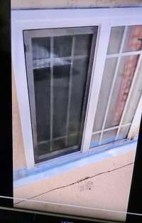

Patio cover roof meets a wall. Considering that the window is at the second story, a roof six inches lower would have been okay. At what stage of the construction did they realize that this will not work? I'm guessing ledger. The cover is 40' long and window is near one end. The people that put up the ledger had to know....and did it anyway. They weren't starting over with thirty feet of ledger already screwed to the wall.

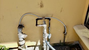

The job is a 400 amp residential service upgrade. The contractor knows that we require a bonding jumper between the cold, hot and gas pipes at the water heater....so he did this:
Looks ugly but it's through an overhang and there's no getting the shingles apart.
