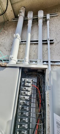

Gastitie CSST. I have written many corrections for exposed CSST such as is shown here. Apparently I have been wrong many times. I recently searched the installation instructions and did not find anything that would require protection of this CSST. I called Gastite and was advised that no protection is required for CSST that is indoors and exposed.

I'm thinking that there must have been a time when the CSST had to be protected if less than 6' above the floor.
There definitly was a time when the electrical bonding jumper had to be a solid #6 conductor and now it can be stranded #6.
Looks like a compliant install, you even have the yelow tag on the connection piece, did you follow the yellow CCST to the bonding point?

The gas pipe does not have the #6 bonding jumper.

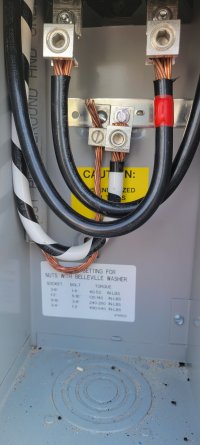

The contractor added a GEC lug to the inside of the enclosure that gets sealed off by the utility. 250.24(A)(1) does not permit this.
Our meter enclosures are generally accessible...What do yours look like?
Here is a before and after. The terminals are the supply side of the meter. The latch at the bottom is where Edison places a seal. Edison places a seal to thwart theft.
Both of these pictures have a violation.

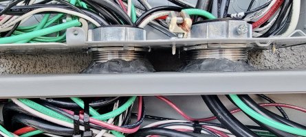

This was presented as a rain-tight installation. The contractor stated that they do this all over southern California and this is the first time that it has been rejected. The inspector identified the material as duct sealant. The package or container has a UL mark on the label. The description that I found does mention preventing moisture from entering conduits, enclosures, etc. it also states for indoor use only.

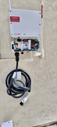

Solar inverters are now including an EV charger built in.

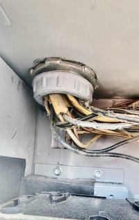

The job is a service panel upgrade and it was done by a licensed electrical contractor. The pictures were sent to me by an inspector.
Those are just EMT connectors penetrating the top of the panel? A hub or sealing locknut should have been used, NM cable is only allowed in dry locations so there a problem with that too.Whats with the single conductors mixed with NM cable?
