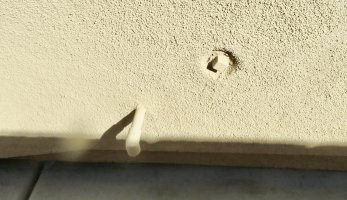

The picture is the AC disconnect. It is placed over a hole in the stucco wall. That's a zip-tie stuck in the hole and there is another opening above the missing cable connector. The can is against a window trim and caulked on two sides.
The refrigerant line set comes out of the wall through rubber gasket that is torn enough for mice to find a way in.

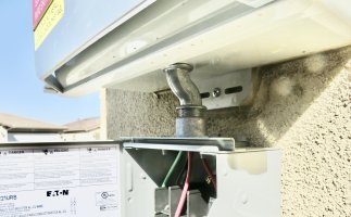

And one of my favorite violations; There is an offset nipple screwed into a hub.

The disconnect was placed over a finished stucco wall. I can't identify the wiring method from the pictures but I am convinced that it is a cable. There is a hole in the stucco and most likely wall sheathing.
The offset nipple into a hub is a listing violation in that hubs have not been evaluated with straight threaded hardware. The hub has tapered threads and the nipple has straight threads. The nipple threads will not correctly engage the hub threads. This is a common practice in the solar industry.
I performed an experiment to see if the hardware is watertight. It failed. The hardware in the pictures is larger that what is used in the solar industry. I have replicated the result with the smaller hardware.
The nipple was threaded to refusal. I used a device to place water at the top of the hub. It drains slowly but after less than a minute the water has seeped through the connection and capillary action takes hold. The water then flows readily through the threaded connection.

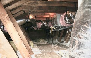

The first picture is the access path to the furnace. The return air duct blocks the path. The city inspector and the HERS rater did not enter the attic.
