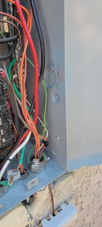

The job is a residential service panel upgrade done by a licensed electrical contractor.
There had been a large LB on the side of the enclosure. The door was notched to clear the LB. The LB served no purpose and an inspection wrote a correction to remove the LB and fill the missing KO. The contractor removed the LB and welded a patch. The door also has a welded patch to repair the notch. I didn't get a picture of the outside weld but I was told that it looks a little better than the inside weld. It has been painted and the paint is flaking off.
A different inspector has been sent there for a final inspection. That inspector asked for my opinion.

The panel enclosure arrived with an LB attached which indicates that the enclosure is not new. The door had to be modified to clear the LB which indicates that a hole was punched in the side of the enclosure, The weld is amateurish at best and the paint is already failing. In the not too distant future the side of the enclosure will be rusted.
I advised the inspector to turn it down based on 110.3(B) and 110.12. I also told him that if the contractor complains to management the correction will most likely be overturned. The reasoning will be that the intent of the code has been met and any future defect will be the result of improper maintenance.
One of the criteria that I will apply is what would I accept were I the customer. Now I know that is not okay by the strict application of code or even the job description. Consider it to be a thumb on the scales of justice. I don't do that every time....just like I don't turn down holes punched in enclosures every time....sometimes I add it all up and just a small nudge pushes it off the cliff.
The code does not require all GEC to be protected with conduit....it depends on the size of the wire and if there is the potential for physical damage. The #4 stranded in the picture is the GEC and there is a missing bonding bushing and most likely a a cable clamp was used to secure the flex to the cabinet. To the right of that is an inter-system bonding terminal.

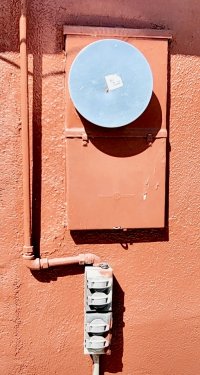

Usually see a plastic cover and some have a handle
312.2 says that in damp or wet locations cabinets, cutout boxes, and meter socket enclosures shall be placed and equipped to prevent moisture or water from entering and accumulating within the cabinet, with no mention of a requirement that the product be listed.
However, any equipment you use (listed or not) has to be approved by the inspector to be legal (110.2), and I bet that thing is listed for something, but probably not listed for weatherproofing electrical equipment, so it wouldn't comply with 110.3(B) because it isn't installed in a way that meets the manufacturer's instructions. It's really up to the inspector - which in this case is ICE - so he has very firm footing to reject this installation.
Listing and labeling is intended to be a guide to help inspectors be more comfortable with the products they are approving under 110.2. Therefore, if a product is required to be listed under the code, it needs to be listed and comply with 110.3(B). In my opinion, if a product is used in a way it wasn't intended to be used, and what they are using it for isn't required to be listed, but the product is listed for something else, as in this case, it is up to the inspector to decide if they will approve the installation.
I would tell the electrician to effectively bond that cover somehow, caulk the cover to the enclosure to waterproof it, replace the screw with a roofing screw with a neoprene washer to waterproof the screw hole, and call it good. If they don't want to do that, they can install something intended for the purpose. Odds are very good they will buy a product intended for that use, but if they don't I would still be able to approve the installation.
I like to give people choices...
Plastic is not a permanent solution as sunlight destroys plastic. Caulk is not recommended. Metal meter socket covers are available. The thing about meter socket covers is that they are considered to be temporary. I have seen many panel enclosures that were converted to junction boxes and sub-panels. I have approved many with meter socket covers. I probably should have turned them down due to a lack of confidence that they are watertight.
The pictures of the duck cap were sent to me by an inspector....I can't say "another inspector" anymore because I am not an inspector anymore.
