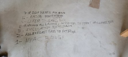

You really don't know the depth and breath of the malfeasance that exists in the building code enforcement community. It is just bizarre.
I met yesterday with a friend that is trying to obtain a permit for a carport. It has taken six months so far and the planner is clueless. The contractor had a list of questions regarding an ADU that he is building. He had inspection for footing and under-slab plumbing that amounted to a few minutes. He wasn't sure that the inspector looked at it and the inspector would not answer any questions....so I did.
I plan on re-piping. I called the building dept to find out about a permit. I was told that I must submit an isometric drawing so that the inspector will know what fixtures were involved. Four full bath, kitchen, laundry and hose bibs and I bet that the inspector wouldn't get past the first floor. I built a 6' retaining wall and called for a footing inspection. When the inspector showed up I was using a shop-vac to get the loose soil. The inspector remarked that he had never seen anyone do that and stated that I am so conscientious that he didn't need to bother with an inspection....he signed the card and left without looking.

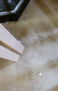

The AHJ did away with paper. Inspectors have iPads in which they are to enter corrections. Well they are not all up to speed with that. One inspector writes the corrections on floors and walls. Following behind him is an Easter egg hunt.
It is actually an improvement over the paper correction slips.
That correction notice is flippen ridiculous! The contractor should scream, how about something I can read. I would have an inspector on the carpet in front of me.
We write corrections in an ipad, but I also bring along a black sharpie to write on areas to help contractors find where they need to do a repair on framing or vapour barrier inspections. Just an arrow or circle to help them find what I am talking about.
It seems easier than trying to describe where an issue is sometimes and contractors are not always on site to meet us.
