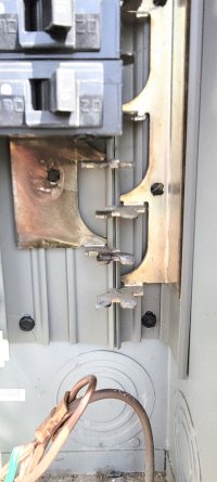

The inspector was there for a solar inspection. The solar breaker is required to be at the far end of the bus away from the main breaker. It was not. The person that met the inspector moved the breakers from the far end because the bus was scorching. As the inspector was writing a correction, well actually, the inspector was taking notes.... the workman decided to remove the solar breakers. When he touched the breakers he recoiled in pain as they were starting to melt.
The c-tap and loose ground wire are another issue.
