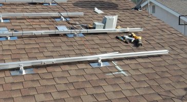

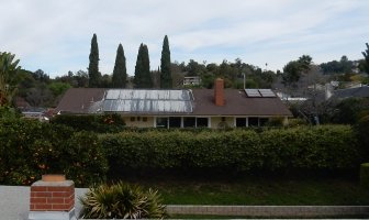

When we go out there and don't mention the fact that you got a little carried away with the bootlegged patio cover we send a message that may not be appropriate. But that's the way we are, especially with solar. It's like, "get it on the roof no matter what". If the building isn't on fire it qualifies for solar.
They filled these gas cans and drove out without securing them. They're just sitting in the back and these two are hoping all goes well. There's eight or ten of them.
Did you now that every section of rail is required to have two supports? So far it doesn't matter who's racking it is because all that I have seen have that requirement. You will find it in the manual at rail splicing. It says that there shall be a minimum of two supports on each side of a splice.
ICE;
The cantilever looks a bit too long as well.
Fill me in on those rack rail connectors to (hopefully) structure below, waterproofing looks a bit dodgy.
