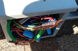

Today's c-crimps.
One of the wires slid out easy like corn through a duck.
