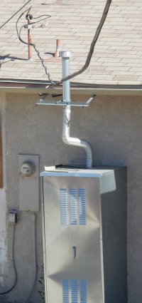

Well the new water heater is here. One of the previous corrections stated that the single wall vent must be a minimum 6" from combustibles.
Here is a perfect example of why I have a terrible reputation.
I am such a prick that I am going to make them fix this conduit.
They will have to remove the furnace that they just got done installing.
There is the nuclear option. They can go to the office and tell the manager that I am rude, I won't listen to them, I am not helpful and they want me replaced......with an inspector that will not make them fix the conduit. Their biggest complaint will be that the conduit was broken before they slammed a furnace into it. My office manager will be eager to please and agree wholeheartedly....you do need another inspector....one that can tell the difference between an existing condition and new damage to that conduit. Gosh I'm sorry he put you through this Sir, I'll have a talk with him.
