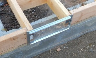

This vent is inside out and is not for use with stucco.
