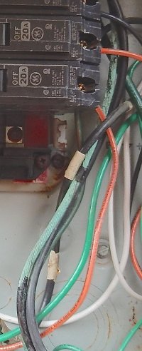

This a a panel that was installed because as you will see, the other panel was too full and the other other panel was too old. The breakers are energized but when I tripped them nothing inside the building went dead. They are labeled bedroom lights and receptacles but apparently have no effect on anything inside and I tried all of it.
Here it is with two of the other panels. All of it is energized.And this isn't all of it as there is another panel at the meter.
Here we are at the meter.
The wire with the missing insulation is fed from a 50 amp breaker.

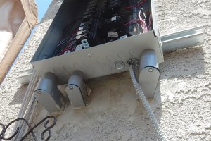

This was a service upgrade mounted over a hole in the wall with the conductors brought through the back. Well I wrote a correction about that so he did this.
The guy doing the work called me before he did this. He tried to talk me outa the correction. It seems that he is the neighborhood handyman. A jack of all trades. I thought that I explained in sufficient detail but evidently I fell short.
For a brief moment I felt a tinge of empathy. If you stand back and look at the work it looks like the person is pretty good with tools but doesn't know what to do with them. Then I noticed that the cover on this LB isn't screwed shut. It's buried in plaster and not screwed shut.

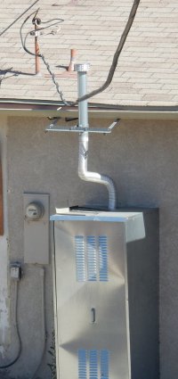

Wow! $152.00
The job is a complete rewire and a service upgrade. The contractor hasn't been there for a while. The request for inspection stated rough electrical. They came up way short on the number of receptacles per the spacing rules. I wish there was a way to stop them from leaving energized equipment wide open for days on end.
A solar contractor is doing a service upgrade. Now I can understand the tall mast.....Edison might not replace the drop so it may be for naught. What I don't get is there is no flashing. The roofer told me that he will cut the boot to fit it around the conduit.
