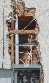

Solar **** did another service upgrade.
You can see the paint line of where the old cabinet was mounted.
They need to get smart about hiring subs to do the upgrades. The low bidder is not always the best choice. I suppose ***** City doesn't care how many times the sub has to do it over but too many inspectors don't care and would approve shlt work like this. Then a few years down the road there's a mold problem. And I suppose *o*l*r *i*y doesn't care about that either.

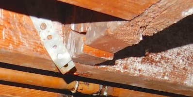

I tugged on a conduit LB on the outside and it pulled out. So I found the underfloor access in a bedroom closet and got this picture.
Sure enough the conduit is floating free.
Then looking at the picture I saw this.

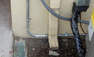

If you don't ask them to remove the tunnel under the service entrance conduit.....
this is what you are missing......
Removing the tunnel is dangerous because it is over the entrance conductor terminals....so stand back while the kid, that has no clue but works for a solar contractor, risks his life.
