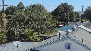

I always check to see what the roofer did to the service drop.
With this house, the drop should be attached right here.
It ended up draped across the house next door.
The re-roof permit was taken out by the owner. The neighbor didn't have a clue about the energized service drop laying on their roof and the owner of the house being roofed wasn't there. I called Edison and they said they would be right over. Five hours later nothing had changed. The way the thing is snagged on the iron vent pipe indicates that it was placed that way on purpose. When I told the neighbor about it, she wasn't upset until I told her to stay away from the plumbing in her house.
