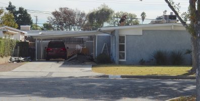

I was convinced that there is a re-roof in progress......the owner says not so and I am welcome to go on the roof to see for myself.
And yes Pc1, there is some HVAC work being done by an amigo in chaps.
