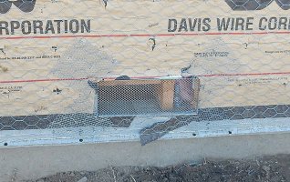

Crack prevention.
I doubt that a few cracks would be noticed.

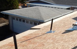

They raised the roof from 1" pitch to this. There's quite a bit more beyond the garage.
Nobody thought about calling for an inspection before they sheathed the roof.
They called for a framing inspection. When I got there I pointed out that I can't see any of the framing. That's when I was told that I wasn't there for that.....nope, they told me that I was there to decide if they really, really need to replace the dimensional garage door header with the parallam that the plans call for.
Well then today I got a call from the contractor. He forgot to request an inspection of the pad footings for the parallam. I told him that I could do the inspection.
Was the roof re-frame under a permit? And is it safe to assume you told them to build the header like the plans?

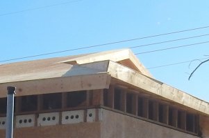

This is the roof from post 1864. Notice the corner.
Here's a closer look.
Here they are a day later...doing it over.
They will fix this next.
I'm guessing that there are a few of you out there that would argue that these problems are not code violations. Look at post #1876 and see what he did next.
