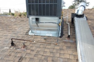

The whirlybird vent looks like it's installed correctly, the rest of the flashing an't pretty or done correctly.
Watch out, there's a big zombie behind you!:cower:
I hate seeing the flimsy fart fan duct.
This duct is much better.
