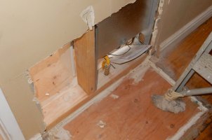

This valve was left in a crawl space where it had served a floor furnace for 56 years. The gas pipe was extended to the attic for a new furnace. The gas valve was closed for the pressure test. The correction said to provide a picture of the pipe with the valve in place and a picture of the pipe with the valve removed. I also asked for the valve.
What gives you the authority for that?
A tool is required to operate the valve. A valve shall be accessible. There is no listing for the valve. I usurp authority. I'm going with the last one....that way I don't have to come up with a code section.
If you cannot come up with a code section you are abusing your authority.
Were listings required for valves 56 years ago?
If you cannot come up with a code section you are abusing your authority.Were listings required for valves 56 years ago?
That's the beauty of abusing authority and I don't know what the codes were in 1960.
Don't you have the historic codes? ICC sold a CD with historic codes on it last time I was in their store.
We have the code books so I could find out. Whatever the code was in 1960 has no relevance to the reuse of a valve today. Mark K has confused cannot with will not.
The key to this valve is grease. Grease makes the seal. 56 year old grease.

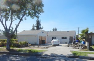

The bricks are dislodged because everything on the property is moving towards the middle of the street.
Is there any major damage to the property or mostly cosmetic damage like this? Is the house on a hillside that's moving, if not what's the cause of the movement?
The house across the street was just brought back to level. It was jacked up and a new footing was placed under the existing footing. The slab was replaced as well. In 30 feet it was tilted 12". It had been like that for twenty years. The explanation I was given was is that there is a band of poor soil that runs with the street and all of the houses are sliding towards the poor soil.

R104.9.1 Used materials and equipment. Used materials, equipment and devices shall not be reused unless approved by the building official.
