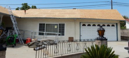

Working right along without a permit.
The hapless homeowner hired a Home Depot parking lot crew.
That's the garage and of course they denied roofing it.

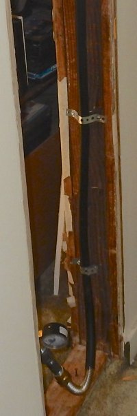

I screwed up when I stopped.
Today was the third trip and not much progress has been made. The last time there was supposed to be a pressure test....the gauge read zero PSI. Today there was another attempt at a pressure test. The gauge reads maxed out but there is no pressure in the pipe. I always release a bit of air to see if the gauge works. As you can see they don't know how to treat CSST.
I called the contractor. A receptionist transfered me to "one of the Installation Managers". That guy did not know what CSST is. I told him that the CSST must be removed and hard pipe installed. He said that I can't do that if they are able to install the CSST correctly. So I scared the homeowner with the truth....she will demand that the CSST be removed.

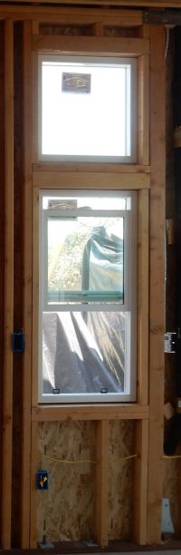

I like it, the is no reason to waste all the wood we put in to frames, split jacks carry the load just fine, the small opening (Less the 8 feet) with double jacks, king stud and a jack under the sill is a waste. BTY why do they put double sills, the is no need for that either there is no need for piles of studs at intersections, move the window to take advantage of the lay out, leave the extra stud out gives better insulation coverage
This is an email that I received after I left a notice at the front door regarding a plumbing permit for a water heater that is about to expire.
"You left a notice at the above address regarding a plumbing permit that's about to expire. If it's related to the A/C Installation I did there more than 5 years ago, you inspected this installation. You might remember I had the pressure gauge in the hole where the old floor furnace was and I pressurized with 60 psi of nitrogen (I told you it hadn't moved in 2 days). You bled down to 15 psi and passed it. I remember telling you that LIQUID nitrogen at 70 degrees produces 10,000 psi of pressure. Do you remember this? Does this resolve the open permit?"
My main concern with the trimmers in #2047 is all the cross-grain lumber will shrink more than the full stud next to them, so the full studs will end up taking all the load. That's OK for the narrow windows, but could be a problem on the wider windows if there is a floor above.

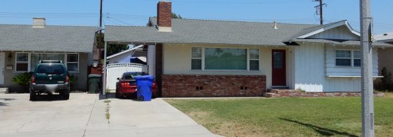

There's been an anonymous complaint about "a carport built to the property line without a permit".
There is a permit from the dawn of time for a house and no separate permit for a carport. It appears as though the carport came with the house.
Now if the person that complained knew how to play the game they would have said, "Excuse me but I see something. This guy built a patio cover without a permit"

Good Afternoon Mr. ######,
I am the homeowner at 9484 ******** Avenue in #######. You recently inspected the roof on June 20. You wrote that singles may not be put on the house because the pitch is too small (1.5 inches).
I am in the middle of a refi with this house and want/need to get the roof done by the appraisal date (July 1). Therefore, I had some questions.
1) Is there an adjustment I can make to the roof that would allow me to use shingles? I see numerous homes in my neighborhood with the same roof as me. They all have shingles so I am wondering what changes were made to pass inspection.
2) Rolled roofing is, well, very unattractive and I fear it would lower the value or appeal of this home should I choose to sell in the future. Could extra layers of felt be used before putting on shingles?
Respectfully,
6-24-16
Mr. ********,
Unfortunately, shingles are not permitted below a 2” in 12” pitch. The fact that there are dwellings with a low pitch that have shingles may be due to a lack of a permit or a mistake made by all parties involved.
Rolled roofing is not the only option as a rock roof would be allowed.
6-24-16
Thank you for your response Mr. ######.
With all due respect, all of the homes in the area are shingled. Having a rock roof would make my house stick out like a sore thumb. It is not aesthetically pleasing. Furthermore, it releases harmful fumes when being put on, and, having a son with asthma who is sensitive to air quality, I have concerns about that. When I bought the house it had a new roof that was shingled. All I want to do is the same thing as all of the homes in my neighborhood. If every other home is allowed to have shingles, including mine before the tear-off, even with a pitch that is 1/2 inch too low, I really don't understand why this is a problem if I do that. I understand your point about building codes, but if I am being held to that standard then shouldn't everyone else? Also, it escaped the city's attention that so many homes were shingled and shouldn't have been? I am trying to do right here by pulling permits and doing everything out in the open, yet I am now on my 10th day without a roof and all of the material is sitting on top of my house. That just isn't right.
Respectfully,
6-29-16
Nothing to report.
Rip some 2Xs on an angle. throw some plywood sheathing on top. Congratulations, you can now use shingles. Don't want to do that? Well, don't use shingles then. I often wonder how hard life is for stupid people. It must be horrible.
Most banks will not accept rolled roofing as an approved material for financing purposes
Instead of installing 2 layers of 15# felt as an under-layment for asphalt shingles as required by the code the homeowner could use self adhering ice and water shield as an under-layment for the entire roof prior to installing shingles. Wind driven rain is the problem with low slope roofs and asphalt shingles and the fact there is no warranty on a roof with less than a 2/12 pitch
What I don't understand about the inspector's suggestions is why he didn't suggest something we've done forever, usually on 4:12 pitch homes that have porches where the pitch flattens out. namely install roll roofing and apply the shingles on top of the roll roofing. It is mandatory now to install a light-colored roll roofing under tile roofing of all pitches, apparently an energy code thingy to reflect heat up to save the planet.
