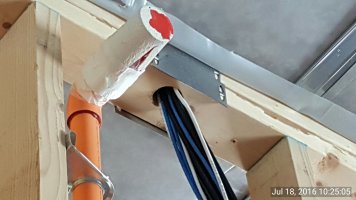

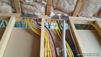

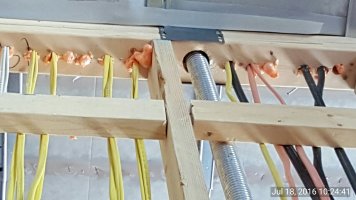

Never seems they can get it right the first time, even worse they are there and only do some, one or none.Would been more cost effective to do right the first time. :confused:
