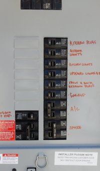

Service upgrade by a solar contractor. The bottom 50 amp breakers are labeled "spare".
Each breaker has a #6 landed so I asked the contractor where the other end of the wires are terminated. He said that he doesn't know. From here they go to the previous service enclosure which is now a j-box. There they splice and disappear into the wall. He assured me that everything works with the breakers in the open position so they are obviously spares.
Why no arc-faults?
Is there a range in this house and what size breaker is being used? Is the double fitty going to a sub?
