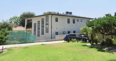

Is it just me or does all of that venting and equipment on the roof ruin the aesthetic. I guess that nobody was paying attention to the plumber as this progressed.
I like a huge glass wall....well not facing the sun. Hence the massive blinds.
How about the chimney in the middle? There are operable panes top and bottom but the blinds aren't helping air flow. There are two wall jacks over the windows....I don't know what they are there for. Kinda look like dryer vents but the location suggests roof drains which I doubt. Perhaps there is a space between the ceiling and the roof and they are vents. I suppose that they fit right in with the chimney.
