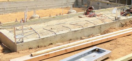

That engineer will give his stamped letter on that for the file right?
3x plates required based on seismic zones,What is that sole plate material? It looks huge, over 2-inches?
Sold in all lumber yards, including Home DesperatePlease excuse my ignorance,
Is the 3x actually a product that is sold in your area? Who makes this product?
 Sounds like you have a golden opportunity calling you." I enjoyed working for the lady "
 The washers are suppose to be 3"x3"x1/4"....I didn't put a tape on it. The correction said "too small" The correction for the landing said,"I'm not convinced that this is a good idea". The contractor reminded me that his engineer said it was fine.
Well actually no, we don't do anything.By "immediate hazard", do you cut the power to the house?
The job is in another inspectors area and I was there while he was on vacation. I haven't been back so I don't know the outcome. I did not call the engineer.So did you call the engineer?? I've done that more than once - like the time I was suppose to verify some lag bolts going into the wall ... the problem was the wall didn't exist. I mean the rest of the dimensions, the rest of the walls, everything else was there, but this pony wall wasn't there (anymore). Don't know what happened to it, evidently someone demolished it but I had the hardest time convincing the engineer that the wall just flat didn't exist anymore. In the end I won, but it was only because I told him I couldn't sign off on something that I couldn't verify.
