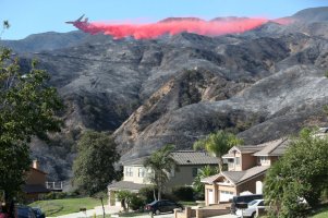

The fire truck was parked in my driveway. Most every driveway had a fire truck. That was last Monday. My neighbors had to evacuate until midday Wednesday. Today is Sunday, six days later, and there are still many fire trucks in the area. At the height of the fire there was 272 engines on the streets. DC10s were bombing the hillsides and dozens of Sikorskys were working day and night.
---------------------------------------------------------------VIDEO---------------------------------------------------------------
The spots are burning embers. It was raining fire. Coyotes were running down the street.
Ominous looking a few hours before the fire arrived.
As the fire got close the tankers started to worry me.

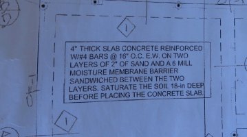

The request slip said "foundation inspection". I wrote plumbing corrections and then in passing mentioned the rebar running in two directions. The worker said that it does run in two directions, East and West just like ther plans state.
There's no arguing with the plans.
Just in case you were wondering, he thought that E.W. meant East and West. So I showed him with my trusty iPhone that he was off by 35°.
