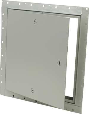

Attic access (R807) - Screws hold shut?
The code does not say anything about screws, locks or fasteners
Code:
SECTION R807ATTIC ACCESSRS07.1 Attic access. Buildings with combustible ceiling orroof construction shall have an attic access opening to atticareas that exceed 30 square feet (2.8 m2) and have a verticalheight of 30 inches (762 mm) or greater. The vertical heightshall be measured from the top of the ceiling framing membersto the underside of the roof framing members.The rough-framed opening shall not be less than 22 inchesby 30 inches (559 mm by 762 mm) and shall be located in ahallway or other readily accessible location. When located in awall, the opening shall be a minimum of 22 inches wide by 30inches high. When the access is located in a ceiling, minimumunobstructed headroom in the attic space shall be 30 inches(762 mm) at some point above the access measured verticallyfrom the bottom of ceiling framing members. See the CaliforniaMechanical Code for access requirements where mechanicalequipment is located in attics.
"...readily accessible location..." Does not mean the hatch shall be readily accessible.
Okay, I agree that this is not addressed in the code, and therefore, allowable. It is code that screws are fasteners. It is my opinion that any accessable opening needs to utilize hardware instead of fasteners as a means of future panel removal. I have a huge problem with sub-par handymen in my area. These guys like to cut every corner they can. I'm not gonna let them get away with it.
The second one isn't going to meet the energy code.. the only good purpose I see for an attic access is for equipment installed in the attic. Fire Department will get in if they need to; accesses allow moisture and infiltration. My opinion is my own, however, crafted largely with input from my dear late friend, Brent Synder.
Like I already said, it is acceptable. My opinion is that it isn't what the code intended. My opinion really doesn't matter, but I'm sure I could get 9 out of 10 builders to remove the screws and replace them with some sort of hardware.Posting pictures doesn't change my mind or make it any better. Here is a perfect example:

"but I'm sure I could get 9 out of 10 builders to remove the screws and replace them with some sort of hardware."
And that is what our good friend brudgers would call, making them "dance the dance"..............................
The obvious substitute for a screw is a nail.
