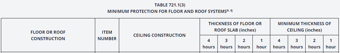

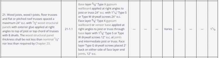

CBC Table 721.1(3) item #21 does not specify the depth of the dimensions of the floor joists at all, and only requires them to be spaced no greater than 24" o/c apart. With no minimums, that could work for 2x8s at 16" o/c. Floor thickness is min. 1/2 of plywood.
You put (2) layers of 5/8" type X gyp board on the underside of the joists to get the one hour rating. This adds up to 1 1/4" of gyp board thickness.
This does not solve your sound rating, but it does solve the fire rating.
