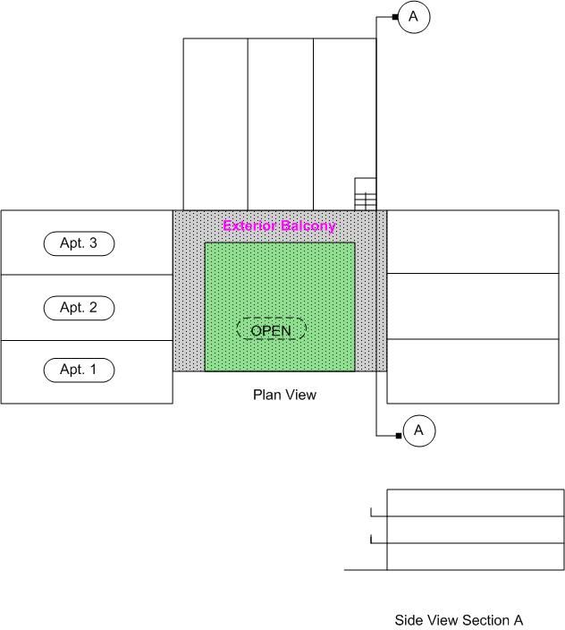

texasbo: I was hoping my 'picture this' visualization would help to understand that each separate apartment building would have only 3 units per floor [hence qualifying for one exit] and that the two apartment buildings would zero-lot-line with the vertical exit [building #3] which would be accessed from the balconies of the two separate dwelling buildings. The two-hour verticle exit would be under a common roof with the 2-hour walls from footings through roof providing the separation between the buildings. Does this make sense? Does it change your opinion? Thanks, Carol
View attachment 1080I picture it like the attached. It sounds like there is an agreement that the overall concept is doable. However, in your case ewenme, they do not comply with the 50' travel required by 1021.2 so they have to revise their concept (or footprint layout) or I don't see how you can approve it.

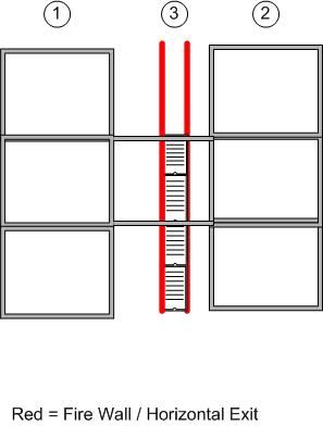

I still do not think this would meet code, as a hortizontal exit cannot be the only exit........it can only make up 50% of the required exit.
Is this the concept you are posing ewenme?
Numbers above buildings indicate building number..... as in bldg. 1, bldg 2. bldg.3
If thats it then I agree that it would not work.

That is the way I pictured it and it would be a verticle exit enclosure not a horizontal exit and it could work except for the travel distances

Your drawing isn't quite the same as the proposal: if you were to look at it in plan view, your three apartments would be drawn perpendicular to the stairs, and then in the face elevation you would see 9 apartments on each side of the verticle exit. I hope that clarifies one point. The balconies would start from the fartherest apartment on each side, but are not planned to extend to the end of the building, only to the door of the end apartment.

I still do not think this would meet code, as a hortizontal exit cannot be the only exit........it can only make up 50% of the required exit.[
In this concept, a firewall was used to create seperate buidlings. A firewall can be used as an hortizontal exit. However, in this concept, it would not be allowed as building 1 & 3 do not have any exits provided except for the hortizontal exit.

The buildings with apartments don't have any exits except into the separate stairway building. The path of egress travel goes from one building (the apartment building) to an area in another building (the stairway building) on approximately the same level. If that isn't a horizontal exit, what is it?
Paul you may be walking horizontally, but in your set up dies not meet ibc definition of horizontal exit
Because the building you are walking out of has no other exits as required to be a compliant horizontal exit

I think in this case it would be an exit enclosure. The designer could simply state that they are not using it as a horizontal exit because they are not required to. They would only designate it as a horizontal exit if they needed to obtain the benefit of a horizontal exit. In this particular case they can not make it a horizontal exit because it is a single exit and horizontal exits can not serve that purpose. And they do not need to because it is an exit stair. So it is an exit by a different definition.
