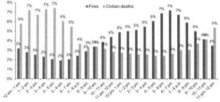

I would like some more details in the statistics. I would like a break down of the number of working structure fires for residential structures while occupied vs fatalities because I think the survival rate might me significantly lower. How about number of working residential structure fires at night while people are sleeping vs fatality rate?
This is from a NFPA study. It clearly shows that the problem isn't that the building is on fire, because when most of the fires are happening is when the least number of deaths occur, it has to do with the activity of the occupants. At 5-7PM most of the fires are happening, but people mostly awake and alert, so there is the least number of deaths. 3-5AM we are seeing very low numbers of fires, but it is the highest death rates. If your objective is life safety, all you need to do is notify the occupants that there is a fire, which means increasing the requirements for smoke alarms. If your objective is to reduce damage to the building then hood suppression systems should be required.
Good stuff tmurry!
The exceptions in section P2904.1.1.
Garages, carports and exterior porches do not require the sprinklers.
Does the research take these areas into consideration? Are there less garage fires, not requiring sprinklers in a garage or is it because we don't heat the garage and that's why there's an exception?
