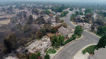

The Photo is taken months after, you can see some of the regrowth on the trees
Soot, ash and debris have been cleared from around the structure and the road to it.
and as I stated See Post above RE: Chapter 7A, which is the structure protection.
Sprinklers protect the people
Where/how did you get that information?
The photo is taken from an NFPA video that discusses the importance of maintaining combustibles away from the home.
I got it from Google Photos, not from the video. I searched for Fire Sprinklered buildings in wild fire areas. Woop Woop….
I never said it was the current fire series
I also said with "Chapter 7A, which is the structure protection."
Do you feel better now. nothing is different.
Not about feeling better. The information and evidence that you gave to support your claim was false. The home pictured is most likely not protected by a fire sprinkler system, and even if it is, had no impact on protecting the home from the forest fire.
The structure pictured and being discussed survived because of good property maintenance, which is something the building codes for the most part do not and should not regulate. If you build in a fire prone or susceptible area, then it is necessary to keep trees and shrubbery away from the home. Keep gutters and roof clear, pine needles cleaned up, etc. Use of buffer zones is hugely important. Even a typical underground irrigation sprinkler system and landscaping can be a fundamental part of a buffer zone.
A wildfire is clearly outside of the scope of what a residential fire sprinkler system can handle from a fuel load/heat creation perspective.
Non-combustible materials? That will certainly help.
Obviously you did not read the post relating to Chapter 7A
Obviously you do not know what an example is.
Sure is a lot of green trees and bushes around those homes.
If 7A was part of your codes at the time this subdivision went in how come the other homes where destroyed.
I find it interesting where the word "reasonable" was added to the intent of the code. At some point a code provision could be determined by the courts as unreasonable based on any number of findings changing or empirical data.
