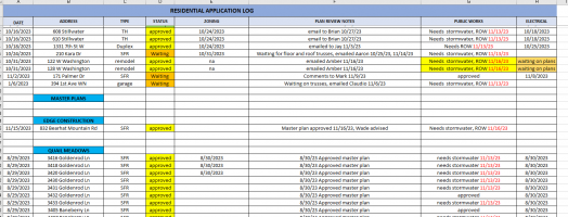

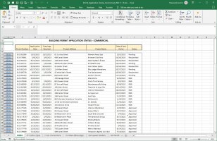

Regarding the comment about a chess timer, I started doing that internally as a way of shooting down complaints that we take too long. It's a clumsy way of doing that tmuuary's software apparently does for him. I created a spreadsheet in Excel, with a cover sheet that shows the projects and their status, and a detail sheet for each project that tracks the progress and processing time. Initially I began with just the cover sheet, as my way of keeping track on which project was next in line to be reviewed. I later expanded it to add the detail sheets.

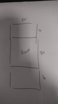

Due to provincial regulations, I can't show you the plan for a house addition I received yesterday. However, the following is a reasonable fascimile. I've painstakingly replicated details on the footings, frost wall, wall composition, insulation details, roofing, etc., exactly as they were presented.
So that deck is an observation platform in the middle of a field?
Builder probably said to the customer: we let the computer draw the plans.
