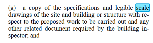

Fortunately, our lawmakers - for as much as they made a horrific mess when they did the first (of five) changes to the regulations back in 2021, got that part right.
What I really like in the above is the "any other related document required by building inspector."
So, I can ask for "show me the specification for the fire dampers used in <location>" or "We request a copy of the truss plan prior to issuance of the permit," etc.

Legible scale drawings are required in our province by law.

Out state does not use chapter 1 of the IBC but has its own version. Scale drawings are required for commercial construction but not for one and two dwellings.
403.42a (d) Provide the scale of each drawing. A building code official may require submission of additional construction documents in special circumstances.
