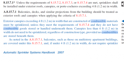

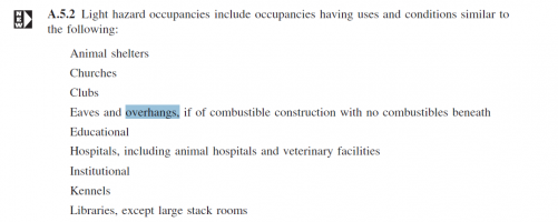

Ok, after a bit more research, here is how to treat areas under eaves.
Be non-combustible (8.15.7.2), clad with non-combustible (8.15.7.3), an exterior corridor (8.15.7.4) or no storage of combustibles below (8.15.7.5).
My approach would be via the final option, 8.15.7.5. If it is truly a roof under another roof, their should be no fire load or storage below. Therefore, although you will have a roof projection greater than 2-ft, no combustible storage occurs below, thereby not meeting the full conditions of 8.15.7.5. Sprinklers may be exempted from underside of eaves (may still be required within the eave as per my prior post).
8.15.7 * Exterior Roofs, Canopies, Porte-Cocheres, Balconies, Decks, or Similar Projections.
8.15.7.1
Unless the requirements of 8.15.7.2, 8.15.7.3, or 8.15.7.4 are met, sprinklers shall be installed under exterior roofs, canopies, porte-cocheres, balconies, decks, or similar projections exceeding 4 ft (1.2 m) in width.

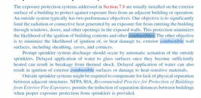

8.15.7.5 *
Sprinklers shall be installed under roofs, canopies, porte-cocheres, balconies, decks, or similar projections greater than 2 ft (0.6 m) wide over areas where combustibles are stored.
Yes however we are not in a fire hazard area. The landscape is pretty desolate. Does that have an affect on NFPA requirements?
I was afraid of that, flat roofs (on which flammable material can collect).
Point being?
The code does not read "where flammable material can collect". It states "where combustibles are stored". Leaf or other litter collecting upon a roof is not justification for sprinklers per NFPA13.
8.15.7.5 *
