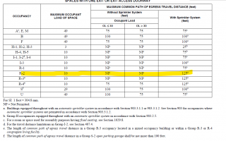

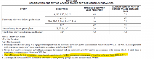

ICC's 2015 re-write of EERO's really complicated things from the previous Editions. Pay special ATTENTION to Tables 1006.3.2(1) and 1006.3.2(2) as referenced. Generally speaking, a sprinklered building with two exits off the Story DOES NOT require EERO's. The occupants (fire fighters) in the R Occupancy are considered non-transient (i.e. they are familiar with their surroundings, un-like a Hotel occupancy). If the "calculated" occupant load of the residential area is less than 16, the occupancy can be classified as an R3, if greater than 16 then the Occupancy is R2. Note, the R3 Occupancy has no handicap requirements (bad idea) and the R2 Occupancy must be Type B Accessible Sleeping and bathing units (better but still not great). What I have typically done is to provide fully accessible (ANSI A117) bathing facilities in the "public" accessible restroom and make the sleeping quarters Type B Accessible. Other Occupancies that are typical in a Fire Station are S2, B and A3 (meeting rooms).

CDA: I think you could argue an R1 Occupancy (pointing out the R1 requirements are more restrictive than an R2), however one of your First Story Units (including bathing facilities) would have to be fully Accessible (ANSI A117). This might be a pretty big trade-off to not have EERO.

Agree with Tim R-2 for sleeping occupancy in a mixed use building. I see nothing in the code that requires a EERO in a R2. For the comfort of the room occupant a window that operates is nice.

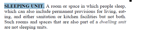

ok that was to broad of a statement, if the area was a dwelling unit EERO is need, not if it is a sleeping unit. I think, what say Tim or Ron ?

TheCommish; Refer to footnote a also, EERO's required. As I mentioned in my previous post, earlier Editions simply said, if you have a sprinkler system NO EERO needed. This has been debated since the UBC days when R occupancies above the third floor in sprinklered buildings didn't need EERO's, then ICBO changed it to ALL R occupancies in a sprinklered building, which carried over to the IBC, until I think the 2015 when the reference to number of exits appeared. Classic ICC, lets muddy the waters.
