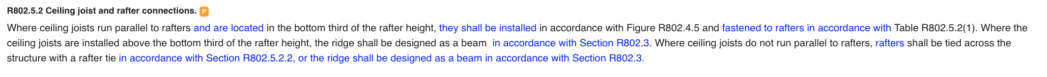

How do you tie the rafters together in both directions with a hip roof? . . . R802.5.2 . . .
There's also R802.4.2, which says in part "Rafters shall be framed opposite from each other to a ridge board," Are we to conclude that R802.4.2 requires a gable roof and prohibits shed roofs and hip roofs?
That's obviously taking things too far. As "rafter" is not a defined term in Chapter 2, the simplest solution to both these dilemmas is to infer from the context that both R802.5.2 and R802.4.2 are referring to gable roofs only.
