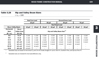

The Canadian code requires the hip to be one size larger than the rafters, so for 2x6 rafters the hip would be a 2x8.
I believe that is what the R802.4.3 requirement works out to for most cases. There may be unusual cases such as very steep roofs where it ends up being more that just one size up, I haven't checked.
Cheers, Wayne

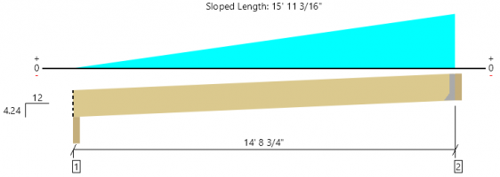

The load on a hip or valley is linear. It is a simple tapered load as shown due to the tapered tributary areas.
The reactions are about 1/3 at the bottom of a hip and 2/3 at the top. A valley is the reverse. There is a rule of thumb that says to use one size larger than the rafters but double it. So, 2x6 rafters would need a double 2x8 hip. (I hate rules of thumb). Even if one confines the length of the hip to readily available lengths, say 16', the load can still be exceeded. This example is a 6/12 pitch roof with max rafter span of 10'-5". The hip is just under 16' and it just fails with a double 2x8 according to Forte. (20 lb. live/12 lb. dead)
Even so, this is a grossly simplified look at the problem. There is a lot more going on here than just a simple tapered load on an angled beam. It would take a solid modeling program and FEA to figure it out, but I would assume it would perform better than the software says.
