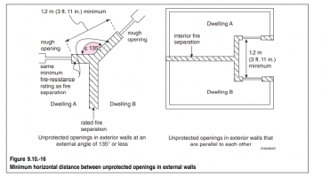

Hello, currently working on a townhouse design and wondering if there any limitations on distance between windows of adjacent fire compartments (suites) in townhouse. The same should be applicable to apartment building. However I can’t find anything in NBC. The wall is straight, no angles less than 135degrees. Thanks in advance.
