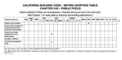

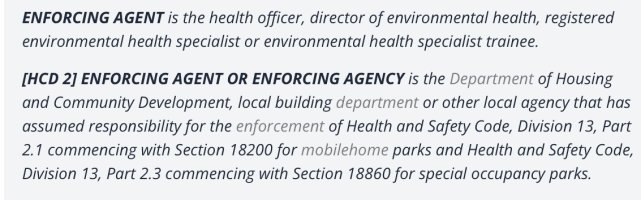

In LA County, isn’t the building department the enforcing agency for LA Co Code 31B?
SECTION 3101BSCOPE
The provisions of this chapter shall apply to the construction,installation, renovation, alteration, addition, relocation,replacement or use of any public pool and to its ancillary facilities, mechanical equipment and related piping. Public pools include those located in or designated as the following:commercial building, hotel, motel, resort, recreational vehicle or mobile home park, campground, apartment house, condominium, townhouse, homeowner association, club,community building or area, public or private school, health club or establishment, water park, swim school, medical facility, bed and breakfast, licensed day-care facility, recreation and park district and municipal pools.
Note: Existing law limits application of building standards.Please see Health and Safety Code Sections 18938.5 and116050.
[DSA-AC] Refer to Chapter 11B for accessibility provisions applicable to public accommodations, commercial buildings and public housing.
