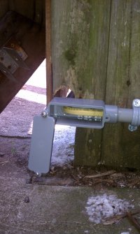

I would like this to be an ongoing thread where we not only post photos of NEC violations but also cite the applicable codes so that everyone has an opportunity to learn or dispute the violation.
I will start it off with this photo that is a violation of NEC 334.12(B)(4) as confirmed by 300.5(B) and 300.9

Jeff, maybe plainly state that the interior of outdoor conduits is a wet locations well....? I think it helps to know what the actual problem is as well as the code section...
