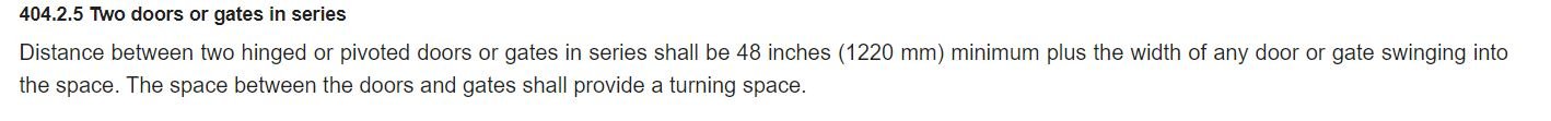

ICC/ANSI A117.1 Two doors in a Series. Distance between two hinged or pivoted doors in series shall be 48" Min. plus width of any door swinging into the space. The space between the doors shall provide a turning space complying with Section 304.

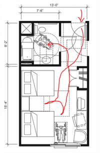

Per the illustration in post #23 from the US Department of Justice, it appears that the implied definition of what makes two doors "in series" is when operation of both doors is the only way to pass through that space to get in and out, without getting stuck between the doors.
To do that, you need to first complete operation (opening and closing) of door #1, then have some method of successfully operating door #2.
In the ADA-compliant hotel room illustration from DOJ (below), you can enter the room, close the entry door behind you, go further into the room, then turn around and go back towards the bathroom. thus the entry door and bathroom door are NOT "in series".
The 48" minimum clearance in 404.2.5 is not about convenience between doors; it's about not getting stuck with zero options in a space between doors.

So by this drawing if a vestibule was the same shape and size as this room and the entry door and the bathroom door were the means of egress this would be ok even when the doors are closer than 48" when open?
Yes, per IBC 1005.7.1, there are no restrictions on door swing encroachment into the minimum required egress width inside a dwelling or sleeping unit.
If it was a hypothetical nonresidential space, then 1005.7.1 would require at least 1/2 the egress width to be maintained, and that bathroom door would probably also have to be shifted down slightly to allow a 180 degree swing so that its fully open position does not reduce the egress width by more than 7".

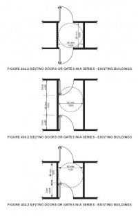

Mark, in your post to Rick you showed illustrations from ANSI 117.1 that are not in the ADA standards. I appreciate these illustrations because they (a) show side walls and (b) show a turnaround.
The enclosing side walls and turnaround make it clear that the defining feature of doors "in series" is that the space Is so small that there is no other path of travel other than either through door # 2 or to turn around and go back out door #1.
‘To put it another way, if (for example) the ANSI illustration had one side wall removed and a 10’x10’ space off to one side, then the 10’x10’ space affords maneuverability, functionality and options other than mere transit from door #1 through door #2. Therefore the doors in that situation are not “in series".
These drawings shown here that are taken out of the ICC A117.1 code book are not referenced in section 404.2.5 (Two Doors or Gates in Series) or anywhere else in the book. They are not code. So how can you use it to explain what is meant by a series or anything else?.

I just sent this to the ICC for a written opinion, I will post it when I get it:
What does it mean "two doors in a series". Is this for 2 doors or more across from each other or next to each other or 90 degrees from each other in a hall, vestibule, toilet room (entry door and toilet compartment door) or any other room on an accessible route?
