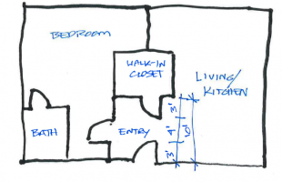

Another crude example - this time a one-bedroom public housing unit that is required to be ADA accessible.
If I put a closet door across from the unit entry door in the entrance foyer, does that mean that it's "in series" and my foyer needs to be at least 10' deep instead of the usual 5' clearance? Notice I'm still able to freely circulate into the living room, turn around, etc.
10' sounds really excessive to me, like it's an entry hall for a McMansion, not for a one-bedroom public housing unit.
This leads me to believe that the definition of "in series" is more about limited, constrained options for travel that might make a wheelchair user get stuck between the doors, with no other way out.

This just makes it more confusing. of course a quick fix is to turn the doors around or a sliding door.
In ICC A117.1 Accessible Units 1102.5 Exception 3 says a turning space between doors in a series as required by section 404.2.5 is not required.
Which seems to say you still need the 4' space between doors. I still wonder if this has to do with vestibules because I never saw one in an apartment.
But then 1102.3.1 says that a turning space is required in each room in the accessible unit except bathrooms and small closets. Isn't a vestibule a room?
I can't find a definition of vestibule in any of the ICC code books so I don't know if it needs to be a enclosed room or if it could be open to other rooms.

I just found this explanation on the US Access Board website.
There are TWO criteria that must be true for a door to be "in series";
1. Opposite each other, AND
2. The only function of the space is to use both door #1 AND door #2, i.e. "travel through BOTH doors is REQUIRED". So if there is a possibility of using the space for any purpose that does not REQUIRE travel through both door #1 and door #2, then the doors are not "in series".
Note that the stated purpose of additional doors in series is to "allow users to clear one door before opening the next". The additional "recommendation" further clarifies that wheelchair clearance is the key purpose.
https://www.access-board.gov/ada/gu...es-doors-and-gates/#doors-and-gates-in-series
