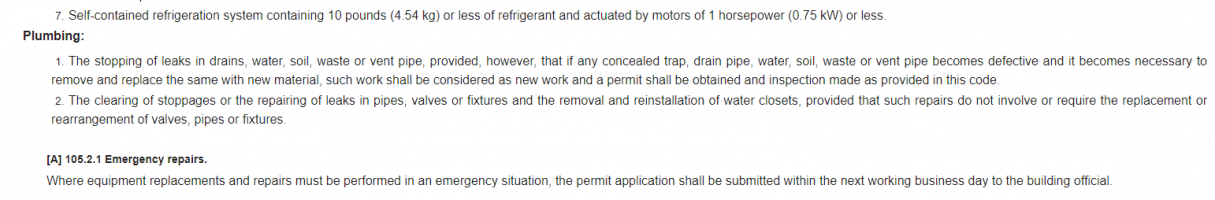

My code has removed the word concealed. If I understand the case at hand, the 4" ABS building drain is located above ground in a crawl space. The argument could be made that the pipe is not concealed.It is all based on what did he do?
Chapter 1 Scope and Administration
2019 CALIFORNIA BUILDING CODE
105.2 Work Exempt From Permit
The stopping of leaks in drains, water, soil, waste or vent pipe, provided, however, that if any concealed trap, drain pipe, water, soil, waste or vent pipe becomes defective and it becomes necessary to remove and replace the same with new material, such work shall be considered as new work and a permit shall be obtained and inspection made as provided in this code.
