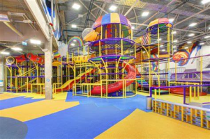

Thread 'Children’s Indoor Playground, Play Structures Building Code Issues in PA'
Hi everyone, I’m hoping someone here has experience or advice on a situation we’re facing! We’re preparing to open a Children’s Indoor Playground in Chester County, Pennsylvania. Most of the preliminary work has been done. We submitted the finalized layout drawings for a preliminary review with the Township. However, we’ve run into an issue. The Township is saying they can’t approve our permit because our play structure layout doesn’t fully comply with the Children’s Play Structure...

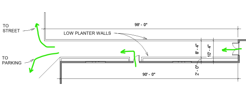

Thread 'Coolers in Exitway?'
The exit pathways in the sketch below run either side of a kitchen in a commercial restaurant and discharge to the exterior. Wouldn't adding beverage coolers on both sides of a portion of the exit way make that portion an extension of the Kitchen thus violating the prohibition of exiting thru a kitchen?
